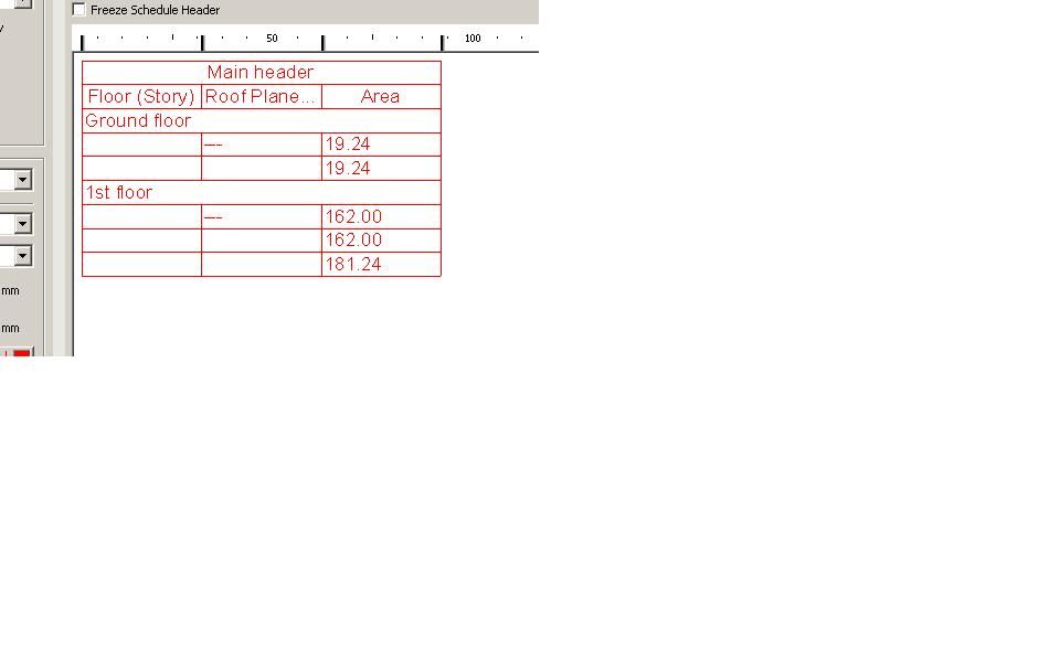

Hi All,
I want to create a schedule that calculates the roof area on the flat and automatically updates. I have a similar thing for the roof area and it works perfectly.
I want to be able to seperate the schedule into ground floor and upper floor and I also want to seperate by roof pitch. It is the roof pitch where I seem to be encountering some problems. There doesn't appear to be an available parameter for roof pitch that works ... I found one called roof plan pitch (under roof accessories), but it doesn't seem to show up in the schedule.
Does anyone have a working schedule that can do what I'm looking for ?
I've attached a screen pic of the schedule I have so far and how I want it to come out. Any help is appreciated
FYI: We are working on AC10 on Windows XP Dell computers

There is no way to calculate this, but it is possible to display it via the element info palette. (its the plan area of the roof)
This is another reason we need calculation fields in the interactive schedules, all you would have to do is have a field that does the simple calc - roof area / cos(roofpitch)

I should point out that with other means, GDL, property scripts etc etc this is very easy. Just not so with interactive schedules
