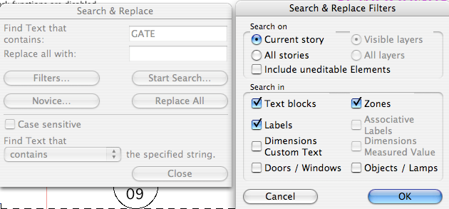

yes there is search and replace, but it looks like it doesnt search and replace user id.

Vaneshrie wrote:
We are working on a project with 196 building on a site. We have completed 100, and the client has decide to change all unit nos. Is there a quick way of searching and replacing ex. door nos to reflect the new change. Eg LG1/01 is now D1/01 and G1/01 is now D2/01.
as long as your label tool is using the door/windows 'ID' attribute for it's label component, and not manually entered text: the 'Element ID Manager...' is not entirely automatic, but will certainly expedite the process.
the order of selection is important . . . otherwise the order of creation (i.e. internal ID) will form the primary sorting order of the elements who's ID you're changing.
or have i misunderstood just what you want to do?
~/archiben
