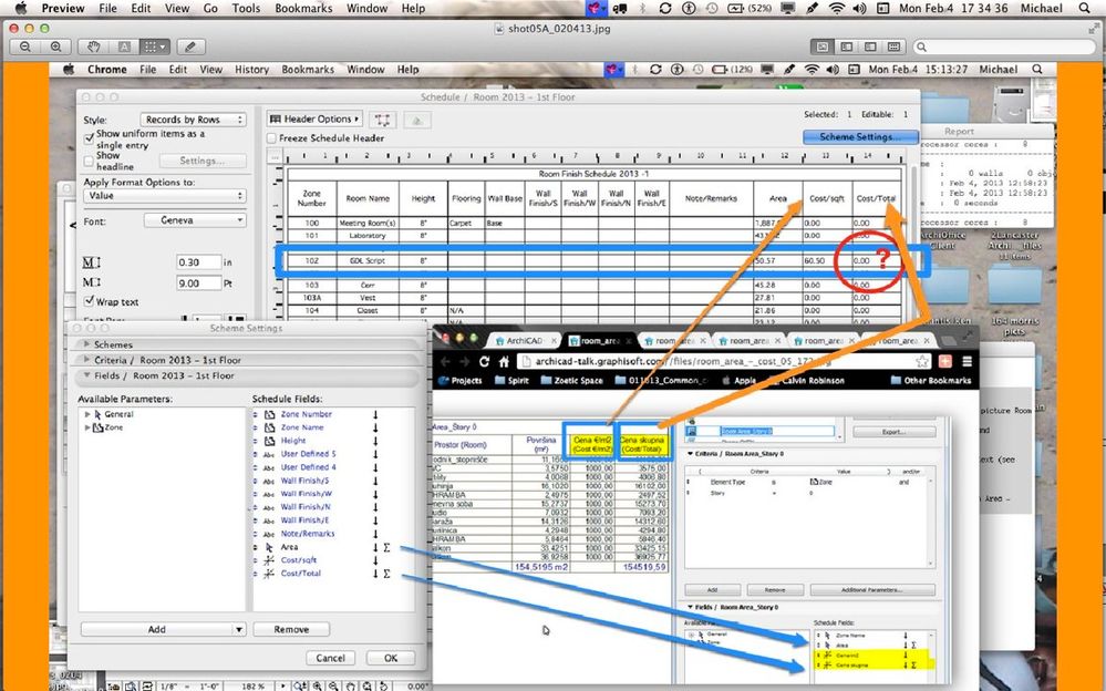

On interactive schedules is anyone using Costs/SF or Costs/Total features in scheme settings ?
If so perhaps can you post a link for tutorial or video aid ?

Michael,
1. I don´t see your schedule
2. Did you execute "Update Zones"?

Found it: delete the "s" in excess!
Michael
Yes Andro55 I saw that too, the typo, and FIXED it and was hoping I could move on .....
But the cyber world said not so fast ......
See schedule and notice how Costs/sqft * Area does not result in Total Costs ..... This is obvious when 0 square footage is in Costs/sqft column.
The one constant seems to be .0929, so the GDL formula is picking up something than what it was programmed to do.
Almost there ! Thanks

Michael,
can you copy the GDL code of the Zone Stamp (from Components, Descriptors, Master, 2D, Properties, Parameter windows if not empty) and paste it in the reply window ?
I will take a look into the code to find the problem.

! Written by Henrik Magyar/Graphisoft 2002.03.19 for the USA market
fontsizeao=fontsizeao/2.835
!!ROOM_LSIZE=ROOM_LSIZE/2.835
PAPER_TO_MODEL = GLOB_SCALE / 1000 ! Convert paper size to model size
w=0
!!!!************** Cost / Total ****************!!!!
gs_list_cost = gs_list_cost_sqft * ROOM_AREA
