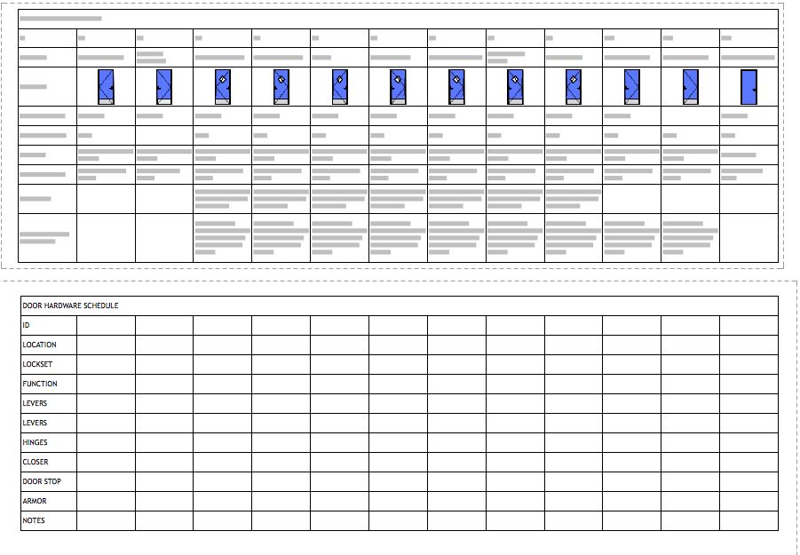

Peter wrote:
There are a number of those parameters already in the doors. You can access them in the object by going to the 'parameters for listing' section in the parameters tab.
For any parameters that are missing by default, use the 'User Defined' generic parameters to add this information. Be consistent as to which one you use for which function.
To create a separate Hardware schedule, you could duplicate the existing door schedule and add in the new parameters by clicking the 'custom parameter' button, selecting the door you are using, then 'adding' the new parameters from the list.
Remove the old parameters from the scheme settings but keep the 'ID' as the parameter that controls the order.
