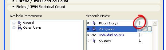

Go into the scheme settings for your schedule.
Then in the fields section turn on the sorting arrow next to the ID.
Can be set to ascending, descending or off depending on what you want.
The attached image is not a door schedule but you will get the idea.

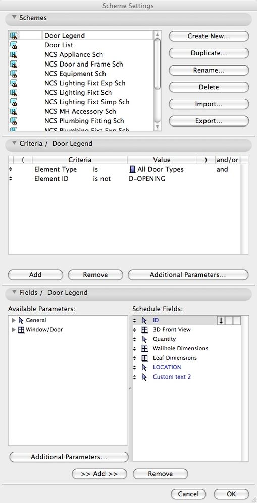

Have attached my scheme settings, the suggestions did not work. I pushed every button, nothing changes except the Doors named Shower move...but the alphabetical listing does not work...any suggestions?
I figured it out. Somehow, when I was lettering the doors, a space was inadvertently added in front of the letters of the doors that kept showing up in front of the A main door. The schedule is correct now. Thanks for all your help!
