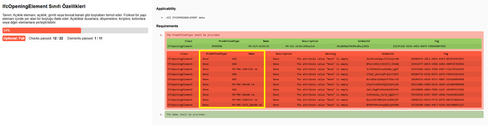

I am experiencing an issue during IFC export regarding the automatically generated 'IfcOpeningElement' entities created by doors and windows.
When validating our IFC models against strict IDS (Information Delivery Specification) requirements, these automatically generated opening elements fail the checks. The IDS requires a value for both the 'PredefinedType' and 'Name' attributes.
Even though I have set up explicit Data Mapping rules in the IFC Translator to assign a fallback 'Name' and specific parameters to 'IfcOpeningElement' (or IfcFeatureElementSubtraction), Archicad ignores these rules for the sub-elements generated by door/window wall cutouts. They are exported with PredefinedType as 'None' (or empty) and their 'Name' attributes are either left empty or cannot be overridden properly, resulting in validation failures in Solibri / BIMcollab.
If I use the Model Filter to exclude 'IfcOpeningElement', Archicad completely closes the wall voids, which ruins the geometry.
Is there a hidden way, a workaround, or a planned hotfix to allow users to force Data Mapping rules onto these automatically generated opening sub-elements without breaking the host wall geometry?
