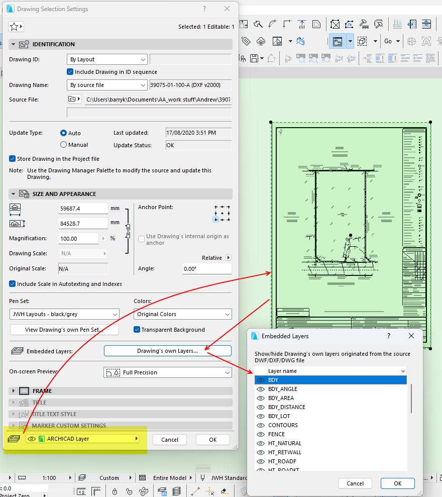

Hi. When I import a DWG into ArchiCAD and drag the view to the publisher set, it's empty. When I go back to the view, the drawing is gone. Can you please help?
1 Solution
@Farnoush Pourmoradi ,
If you use the 'attach reference' or 'place external drawing' option or use the drawing tool, the DWG will be placed in one layer as a drawing.
It will be placed in the layer that is set as default in the drawing tool.
It will not add layers to your file, but you can select the drawing and open the settings, you will see the layers of the drawing (as in my first attached image ... https://community.graphisoft.com/t5/Modeling/DWG/m-p/614663/highlight/true#M172588 )
You have the option to 'explode' the drawing if you want to work on it further.
You will be given the option to 'Use Drawing's Layer' or 'Import Embedded Layers'.
'Use Drawing's Layer' means all elements in the drawing will now be placed in the one layer that the drawing was in.
'Import Embedded Layers' will create new layers (used in the original drawing) that you will have to manually set to be on/off in your layer combinations.
If you use the 'Attach Xref' option, then the original drawing layers will be appended separately to the layer list (as in my second attached image ... https://community.graphisoft.com/t5/Modeling/DWG/m-p/614669/highlight/true#M172591 )
You have to manually turn them on/off for each of your layer combinations.
You can 'Bind' the Xref to your file which is basically the same as exploding the drawing.
The drawing layers will now be a part of your file and you have to show/hide, lock/unlock them for each of you layer combinations.
So if you find a drawing has 'disappeared', check that the layer (or layers if exploded or Xref) are turned on in the layer combination that you are using for the view where you want to see the drawing.

Is it because the layer that the DWG is placed on is turned off in the layer combination used for the view?
Thanks Barry. How can I fix this? I'm currently attempting to import the DWG file, but it's not showing up anymore.
How can I find out what layer is it that I can turn it on and then try to import it.
I place the DWG with the drawing tool.
You choose the layer that you want that drawing to be on and you still have controls of the layer withing the DWG as well - but they are not added to your actual layers - unless you explode the drawing.
