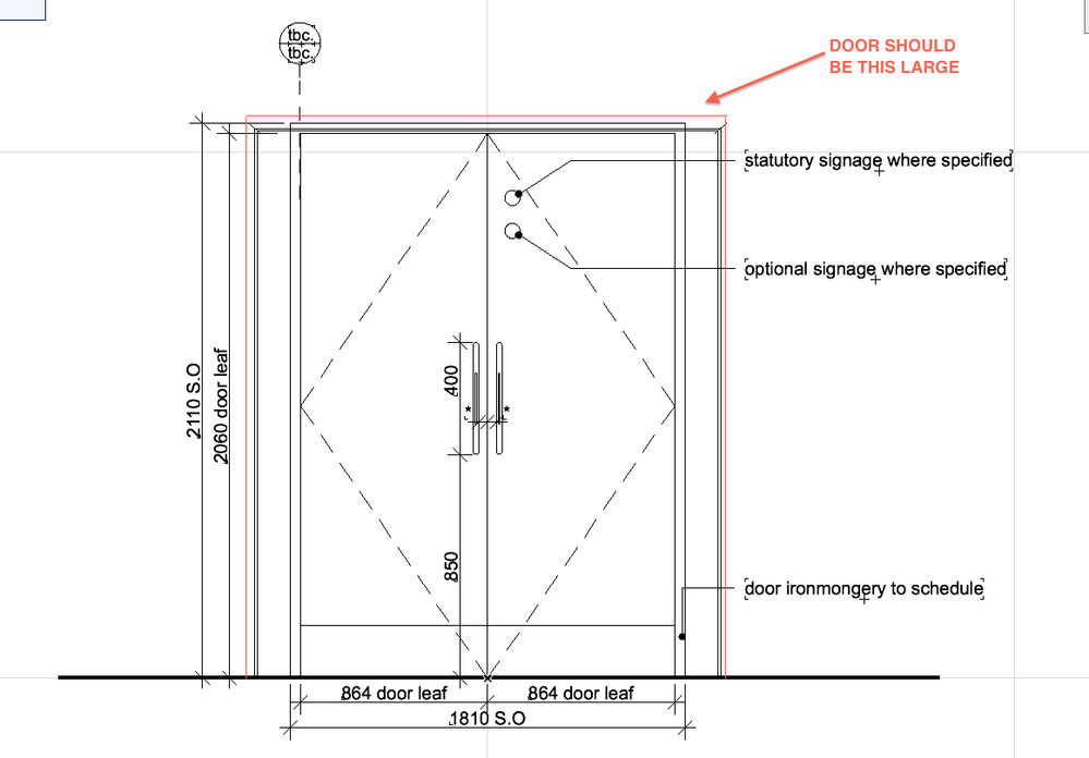

I'm currently having a few problems with my scheduling tool. Attached are a few doors which make up part of an internal door schedule and at random times the doors will resize and flip themselves so the annotations are incorrect. At random times they will flip back and resize so they are correct but I have no idea what is causing them to change (or change back). Do you know why this is happening and how to fix the doors so they don't change? Any help would be greatly appreciated!

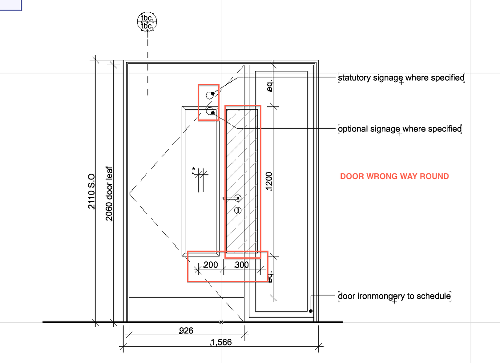

And another picture of another door which has resized...

In schedule the 3D Back View displays the door's opposite side to the opening side. If you flip a door on floor plan, the door flips automatically in the schedules, too. The opposite side of the door changes, but annotations doesn't.
