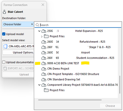

Hi All,
Trying to upload models via the Forma Connector and it's refusing to pull down the full folder list.
I can see all project names as per my profile on Forma, the only some folders are available.
Each time I press the Refresh button I either get no folders, or a few folders (usually different ones each time)
Any ideas?

Hi @Blair_C
Thanks for the message, we have now managed to identity the issue (through the help of logging via another user with the same issue).
We are currently working on a fix and I hope we can deliver in the next Archicad update, and in the final release of Archicad 30 (not guaranteed yet as it’s in progress).
UPDATE: Unfortunately we will miss the AC30 initial release with this fix, but plan this fix for AC30.1 (1st Update) (still on track for AC29.3).
