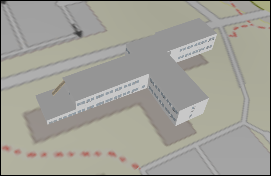

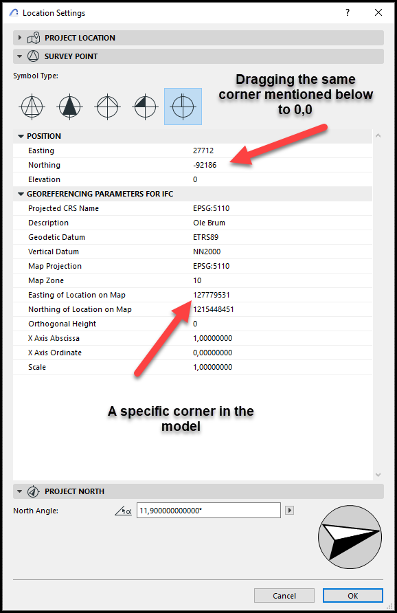

This is where I do not use a Local zero point - and it looks like this: - perfect

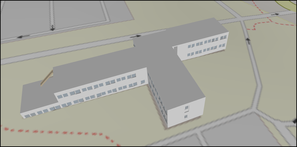

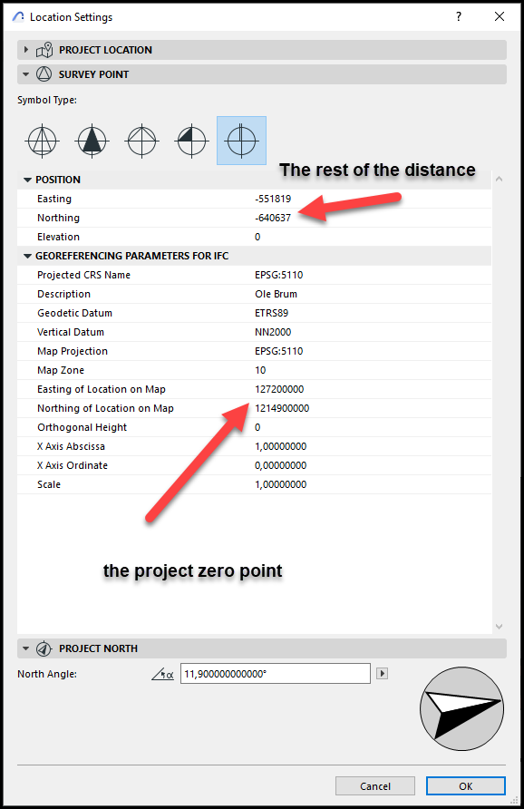

The same building, using a Local zero point, the same corner:
But a different result:
Any ideas? I have calulated the SP-distance using a tiny spreadsheet in Excel. I have used that same spreadsheet several times, but without tthis buggy result.
The only differens this time is the distance between the local zeropoint and the building, 500-600 meters, Can that distance cause that kind of anomaly ??
