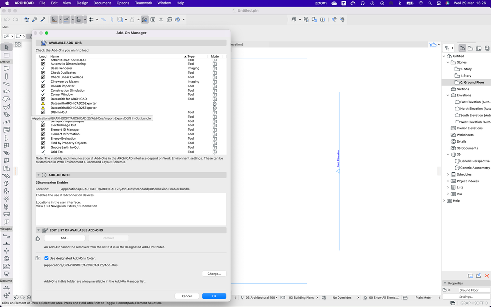

Hello Barry,
I am facing a similar issue. I downloaded Datasmith for ArchiCAD and added it but I have failed to remove the previous versions. The Twinmotion menu also does not show up in my menus. How do I fix this please? I cannot see the menu in WE either.

Hello,
I am unable to remove earlier installations of Datasmith for ArchiCAD as i had already deleted the files. however the new add-on download also does not show in the menu bar. How do i fix this please?
