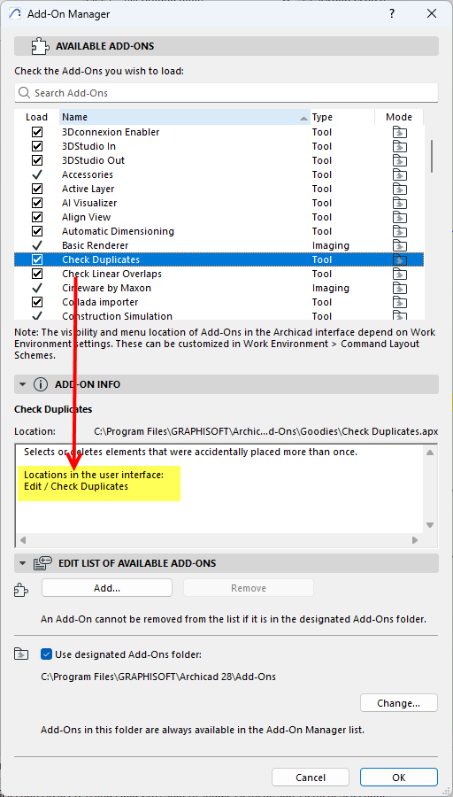

We did install the goodies add-on. We check in the add-on manager if the add-on is loaded and it is. We verified all menu and the tool check duplicates is not there and we did also went to the work environment and it not there.
We did the last patch and didn't resolve the problem.

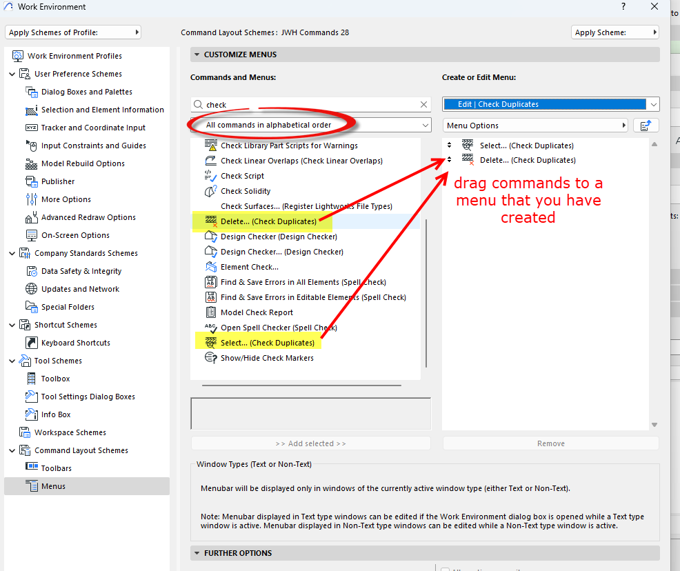

I don't have 29 loaded on this machine, but it should be the same as these images from 28.
If you search by "all commands in alpabetical order", you shold see the commands that you can drag to a menu of your choice.
You may have to create a menu (Check Duplicates) if you want them in your own menu.

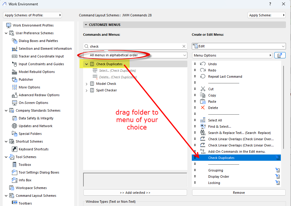

If you search by "all menus in alphabetical order", you should see the "Check Duplicates" menu if it was created when you installed the add-on.
Then you need to drag the menu into another menu of your choice (you can't drag the commands as they are greyed out).
Actually this is the easier option if the "Check Duplicate" menu exists.
The add-on Manager should show you where the commands are supposed to be.

Do you have a custom Work Environment, or a WE from an old version that you are using?
If so, you may need to manually add the commands to your menus.
In the WE, make sure you are searching "All Command in Alphabetical Order" or you will not see them.

Thanks Barry,
That worked.
