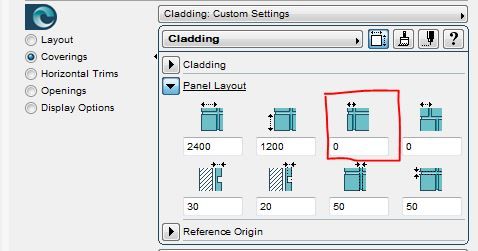

How do I get the cadimage coverings (vertical timber) to line up over 2 floors?
Ive attached a picture

Use the panel offset
Right in front of me! Thanks Roger

Hi All. This conversation has been very helpful in figuring out how to align cladding over multiple storeys' so thanks for that. However, I'm now trying to align the wall cladding with the roof cladding, so as to continue the seams of the vertical cladding up the wall and over the gable roof. The roof covering settings doesn't seem to have an option to adjust the origin. Does anyone have any tips for this situation? Thankyou
Nuge
There is a hotspot in plan view on the roof covering tool that controls the origin point (its usually in the centre)
