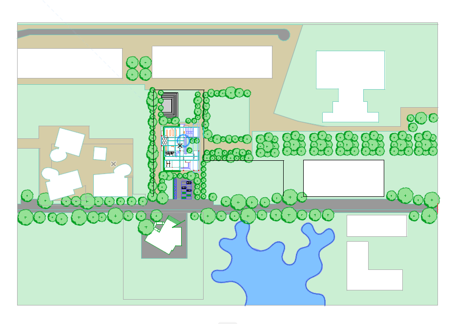

i made a presentation drawing from the line drawing using cover fills setting of slab and other elements ...now i want to to convert that drawing back to the line drawing,but without losing the settings of cover fills which i had done in it...like i want to switch between the 2 drawing presentation with cover fill and line drawing i.e without cover fills....is it possible??
 this is the presentation drawing made using all cover fills

You could set up a Graphic Override to change the cover fills to empty or solid white.
The save 2 views, one using the GO and the other not.
can you pls elaborate your last line.i didnt understand that.
aarkell
I second Barry's response. You could duplicate your view of the presentation drawing and apply a different graphic override (GO) combination. That combination would have a rule that changes all cover fills to be either white or empty, giving the appearance of just a line drawing without the fill colors.
So you would end up with two views. The one you show in your image and a new one, each with its own GO combination.
