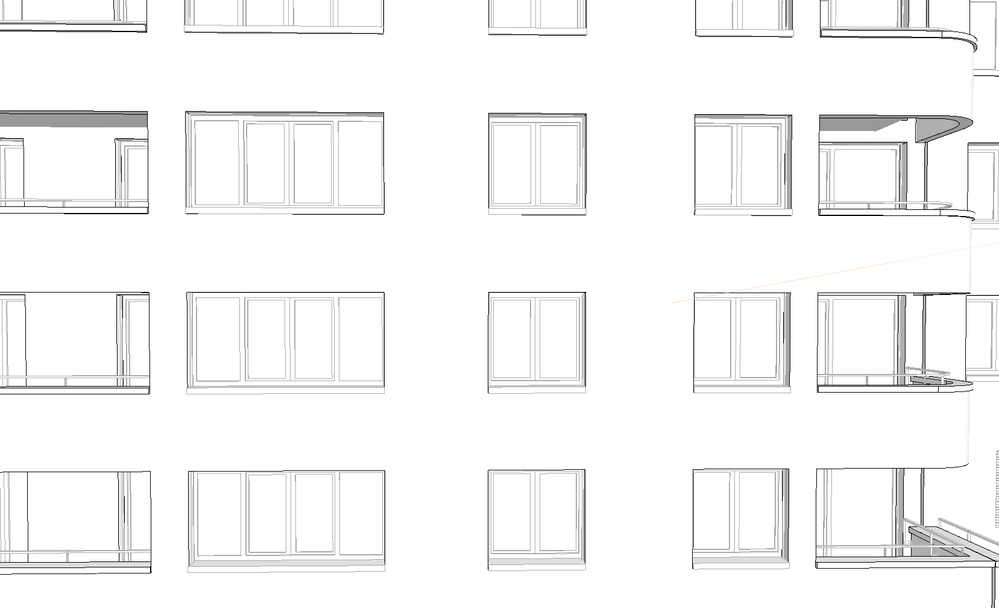

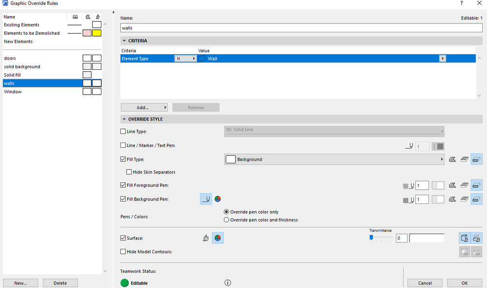

I am working on a window schedule and I would like the automatic elevations of the windows retrieved from the 3D front view to not be in color (see photo). I have created a Graphic Override for this purpose, but it doesn't seem to work as intended. The Graphic Override applies correctly in the 3D view, as well as in plan and elevation views.
The schedule is saved in the View Map with the correct Graphic Override applied.
What else should I do to resolve this issue?

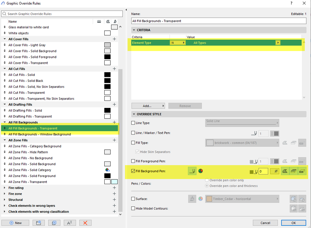

Try using this rule in GO.
Go to post
1 Reply 1
