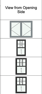

I am trying to create a window schedule showing the "view from opening side." However, I want the windows to be shown with empty/white fills, not the fills of the window materials. I cannot figure out where the settings are to change this, whether it be from a graphic override, window settings, or model view options. Any help is appreciated. The first image below is how they look currently.

Hi @EH21
You are completely right, it is just a graphic override applied to the view you create from the schedule, but it has to be done.
Check this out: https://support.graphisoft.com/hc/en-us/articles/30014049974033-How-to-apply-a-Graphic-Override-to-D...
Best regards.
