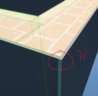

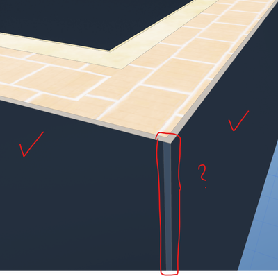

I’m having an issue with Material Override. It works on most surfaces, but on the edges/corners of walls I still get a very thin line showing the original material.
In the attached image you can see that the walls are mostly overridden correctly, but along some edges there is a visible dark/original-material outline. It looks like the override is not fully applying to edge faces or small bevel/side faces.

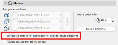

It's because that part is the edge of the wall, which in your case doesn't have its surface override active.
You need to activate this option to use the surface of the adjoining wall:
