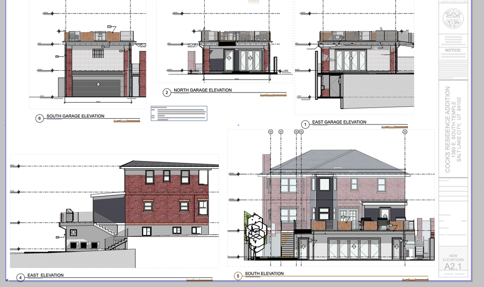

When I publish this layout to pdf and open it in Acrobat Pro, all of the surface textures and colors are bogging down and will not display on the pdf. I have actually had this problem for years, ever since I started publishing elevations with surface texture fills and colors. I sent the plan set to the client and he could not open the elevation layouts either. How do I make sure that all the graphic information in my elevations publishes easily to pdf?

setting to 72dpi seems to help a bit. I have two elevation layouts: and one hesitates, then shows, the other shows an error.

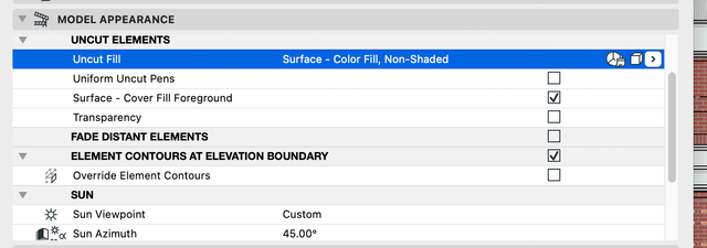

The fact that 72 dpi helps one elevation but another still errors suggests that the failing view contains a specific texture or raster-heavy element rather than this being only a global Publisher setting.
I would duplicate the failing elevation, disable surface texture fills in the duplicate, and publish that one sheet. If it succeeds, re-enable the textures in small groups until the offending surface is identified. Then try replacing that texture with a locally loaded, resized RGB image and publish again through Publisher rather than Print. This should help distinguish a damaged or unsuitable texture file from the general AC29 performance problem with texture-filled elevations.

The only thing that works 100% is unfortunately to just turn off texture fills. When I change the settings per attached the pdf works fine, just not exactly matching the texture in the model, and a little more time consuming.
