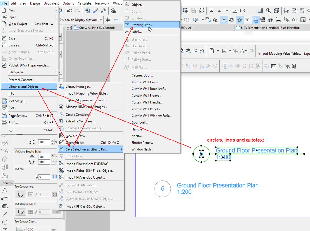

You can create your own drawing title justified just how you like it.
Circles lines and autotext as you want them, select and save as a drawing title object.
But you won't have all of the custom controls (unless you can script your own GDL drawing title).

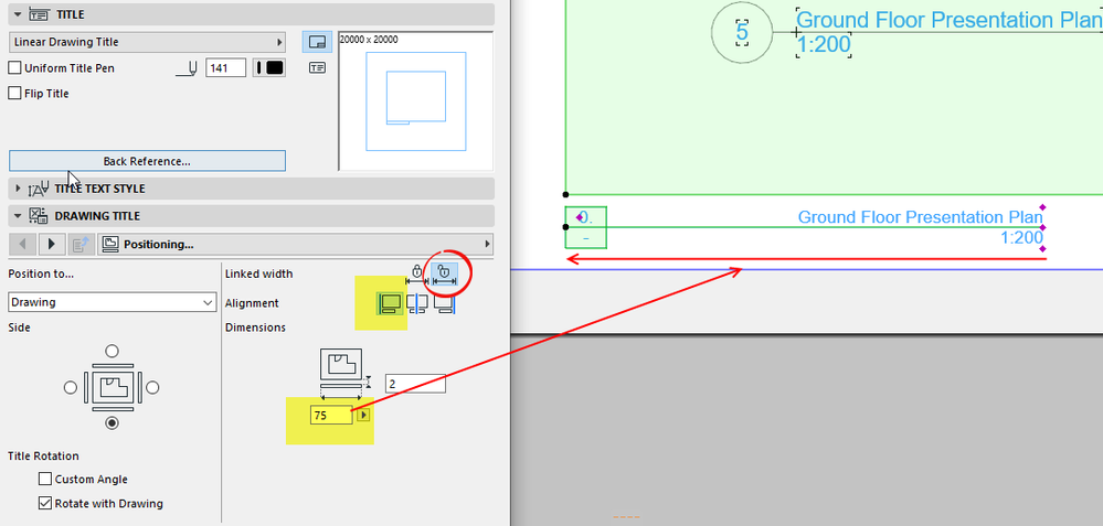

With the linear title you can unlock the size and adjust, but I don't see a way to get it truly left justified.
Save that as default in the drawing tool, and all future drawings you place will have those same settings.
Or you can save a favourite.

And on the other note, for my own interest, I created my drawing title the same way you showed me in your helpful instructions, can you think of a reason my circle would "squish" to an oval from a circle?

The drawing tool is the tool in the tool bar that you use to place a drawing on a layout (or in plans, elevations).
The thing is, we tend not to use the drawing tool when we pace drawings on layouts, if like me, you just drag from the view map to the layout.
But it is still using the drawing tool settings.
If you select the drawing tool in the tool bar and change any settings, you are altering the default settings for all future drawings you place.
If you select a drawing on a layout and change the settings, you are affecting only that particular drawing.
You can also set the default settings by using the pipette (ALT key on Windows machine) and clicking on an already placed drawing that has the settings you want.
With your own label, the circle will stretch to an oval any time you try to stretch (resize) the title.
As it is not a scripted title, it will all just stretch proportionally.

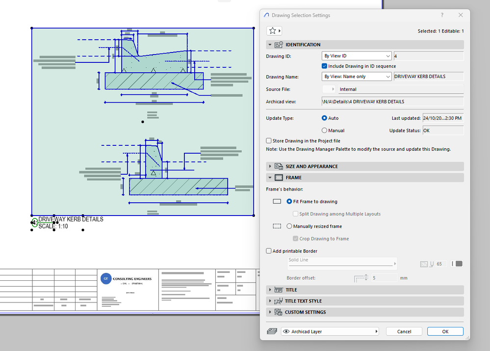

Hi Barry,
I also just drag and drop views onto the layout, I never even knew there was a tool to do this.
I don't have "drawing tool" on my toolbar, but if I go to Document > Documenting Tools > Drawing - my curser turns to a crosshair and then I click on the layout and it prompts me to place a drawing. It doesn't give me anywhere to adjust default settings.
When I select the drawing, I press 'Alt+Space' which is my keyboard shortcut to open up "Tool Settings", this opens the Drawing Selection Settings, am I correct in thinking that is what you and everyone except me are calling the Drawing Tool?
You can add it in your Work Environment, but it should be there by default.
Even if you choose it from the menu, the info box will change to show the drawing settings.
'Tool Settings' will open this in a separate dialogue, which is what you show in your image.
Yes, that is the drawing settings for the drawing tool with a section for title settings.
