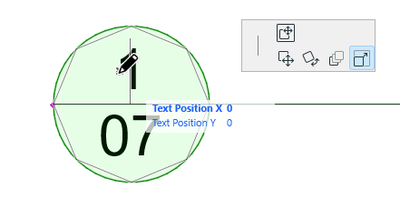

Can anyone tell me how to change the text positioning of the drawing ID and back reference within the Linear drawing title? Ie. centered horizontally in the circle (see attached screenshot)
It only appears to be an issue when back referencing another view. I can overwrite this by showing a custom ID but then it is not truly back referencing properly, also I don't understand why that makes a difference to the text positioning.

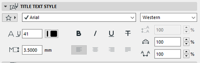

The only text positioning options I can find are greyed out, I don't even know if they are the setting I'm looking for.

Try selecting the title and clicking the magenta dot to move it.

Hi Ricardo, that works thank you!
Seems like a lot of extra clicking though. Would be great if there was a way to set it to center automatically. This isn't very economical.
