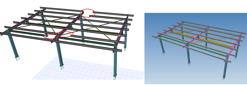

I tried to place an Ifc using “General import” translator and the geometry is incorrect.
Using “Exact geometry” it’s correct, but I would like that architects can see the information, so I would like they use the other translator.

Translating IFC geometry into parametric objects is probably far more complex then just translating geometry data. Geometry and data are well defined through the ifc format standard, while translation processes which recreate parametric objects are not and probably depend on both software, the exporting and the importing one. I guess the translation process which translates construction elements into native archicad elements (beams, columns, etc.) is the one which wasn't working well here. Now if this is caused by the original software ifc output method or the Archicad import settings I don't know. This question should be addressed to GS.

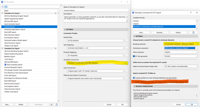

I didn't try to ativate the Profile Attributes in the following picture. Maybe this would give better results?

Ok, thanks, that’s not working but I didn’t know that so it’s great.
I think I’m stuck here because in SIMBIM (one of GS distributors in Spain) need information from Cype (software used to create the structural model). I think I’m not going to be able to have that information. I’m gonna try again.

More info about the IFC import options is available here:
Geometry Conversion for IFC Import (graphisoft.com)
