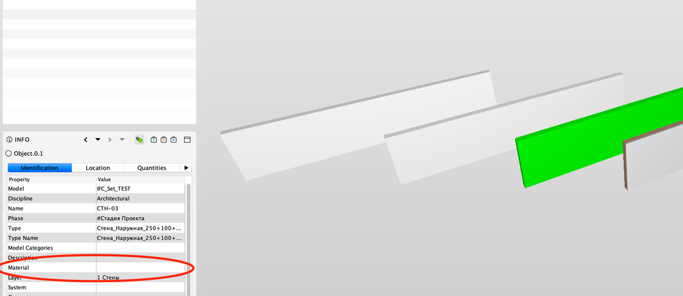

Hi!
We have just realized that the information of the building materials are not included for all of the composite elements when we export IFC from our model. Weirdly it happens even when we export the IFC with "All BIM Properties" and we select all "Archicad Data to Export" as well at the section Data Conversion for the IFC translator.
Somehow the whole Material section is missing for some of the objects when opening the IFC with a viewer (Solibri, BIMcollab). It happens only with composite structures and it is important for us to have this data in the IFC model. In other projects it happens as well, but quite randomly. For some of the composite walls for example it exports this data, but for some of them not.
What do I need to change to have them exported correctly and for every single element/object?
an example of correct data (Solibri)an example of correct data (Solibri)an example of missing data (Solibri)an example of missing data (Solibri)an example of missing data (BIMcollab)an example of missing data (BIMcollab)Skjermbilde 2021-11-01 kl. 13.35.26.png

Based on the screenshots and info, the Composite structure seems to be exploded upon IFC export. So the wall fell apart into Building Element Parts which are the skins as separate elements.
We can change it in the Geometry Conversion tab in the Translator Settings
I'm wondering if this is the problem?

Try to open the IFC file that I attached to the answer. I have configured to export for Navisworks
AMD R7 2700 3.8@GHz | 32 Gb RAM | SSD | GTX 1050Ti
Tried it and it seems that the problem is the same.
In your file there are two walls with the data of the materials which are included and there are two without the information. Do you have any idea what is the reason for this and how can we avoid the problem?

Could it be that the first wall in your example is a basic structure, and the second a composite?!
In the example @hybrid has provided, the two leftmost walls are basic structures, so the material is attached to the whole object. The two rightmost objects are composite structures for which the material is set to each of its skins.
Can you try and select just one of the components in your IFC viewer (for Solibri this is Shift-Click). The material for the skins should be there.

In my example all of the walls are composites and having problems with them only. I have no issues with basic structures.
Yes, I am trying to get the information of the skins which belongs to the composite structures. Sometimes there is no problem, but sometimes it just disappears. It seems like if there was a solid element operation on the wall, then it lost its information of materials in the IFC file for some reasons. (For example a copy of the very same wall, but with a solid element operation on it.)

Dear Nguyen,
Thank you for your comment, it helped a lot!
This was one of the reasons of the problem and now it seems good when I am exporting it to IFC.
