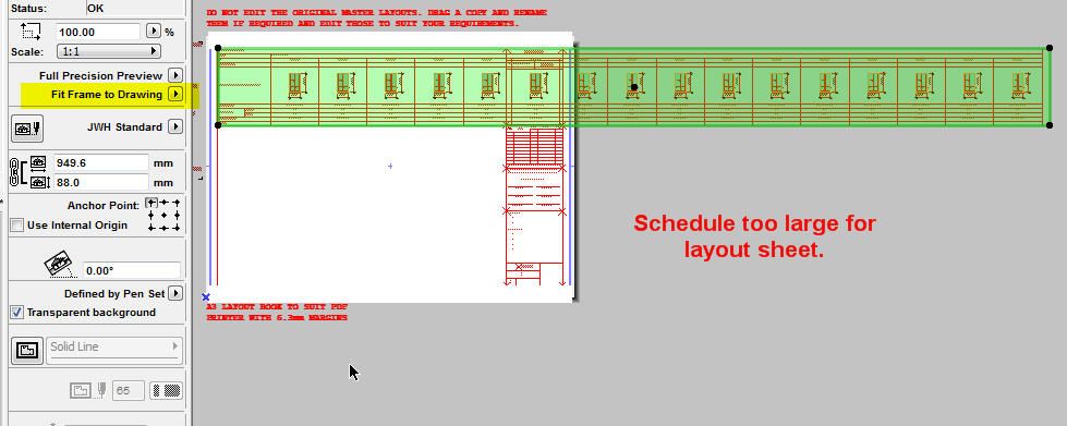

Is there a way to have more than one view per sheet using the auto-split (split drawing among multiple layouts)
My door type schedule, on an A1 sheet can accommodate 3 rows of the schedule - but I can't seem to add a new view (row) to the page other than a duplicate of the existing view.
i could do it all manually but then you lose the automatic finish and start co-ordination - which I like a great deal.

You can restructure the table to manually spread it across the page which then wraps the schedule to fit the space you choose.
But if your schedule is still larger than the page you must duplicate it manually as you say and crop each drawing to show what you want.
As soon as you choose the option to "split among layouts" it converts the schedule back to a single row (or column) and then distributes that among the required number of new layout pages.
I would consider this a bug as I think it is not working as it should.
Some images for an explaination.
Restructuring the table.
Splitting among layouts.
Thanks Barry!
You illustrated the issue well.
