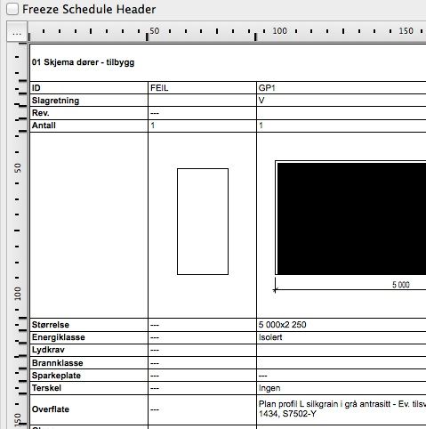

Non-exixtent door shows up empty i schedule
This error is on a project created using AC 15. Same error there, and still around after upgrade today.
I cannot find the door in question anywhere, but it shows up with empty spec in the door scheme.
All other doors are showing correct.
How do I get rid of the door in the scheme?
1 REPLY 1
Select the door in the schedule and then use the buttons at the top to select and show in 2D or 3D.
You should then be able to delete or modify the door.
Or just set your schedule criteria to not include doors with an ID of "FEIL".
This doesn't help you find and fix the problem but it won't show in the schedule.
