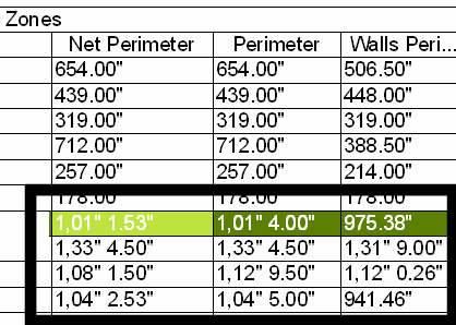

Can someone explain to me what I'm doing wrong to get these odd numbers?

you're getting confused between the 'inner edge' and 'wall reference' zone perimeters, maybe?
if you place a zone with the 'wall reference' method and those wall reference lines are set into, or on the other side of, the wall, the gross perimeter is going to be different from the inner edge perimeter of the walls . . .
and i'm not sure, but wall/column subtractions may also interfere with your gross/net values . . . ?

Here is one of the problem zones. I deleted and placed it again with the magic wand, and I'm still getting those numbers.
Also the zones edges are entirely inside the room!?!? Could this just be a glitch? Maybe I'm just missing something here.

__archiben
at the moment you're missing your attachments! the first one has disappeared on me too . . .
~/archiben
b e n _ f r o s t
__archiben
whoa! strange . . . as soon as i posted your attachments showed up. they weren't there earlier, i swear!
first off - which magic wand method did you place it with? 'inner edge' or 'wall reference'?
second: check in your zone settings>'Area Calculation' to see what - if any adjustments are being made automatically.
third, is your zone polygon set to gross or net?
lastly: zones are a black art! if the above doesn't shed any light, i'm stumped . . .
