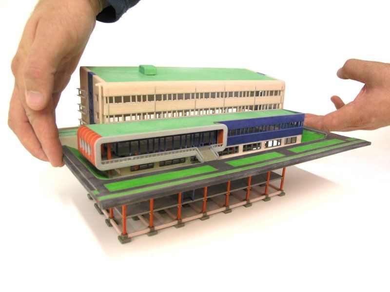

I am very much interested in if anyone has succeed with 3D printing to zcorp.
Please let me know the result if you can. Thank you.
Gorazd
We have done some successfull printing with 3D printer from Z corp (It is know by the name Contex here). The model went out from archicad 10 via VRML. We had to strenghten some walls and other objects, as they became too thin when scaling them to dimensions that printer can produce, but we manage to do print the model on the picture. You can find some info also on this thread: http://archicad-talk.graphisoft.com/viewtopic.php?p=53969&highlight=vrml+printer#53969
You can get STL file also from Maxonform if you have it, but STL has no info about colors.
