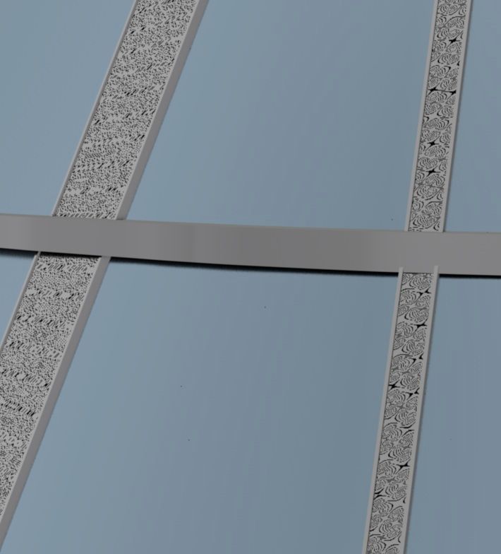

Problem moving an exported structure in C4D
On exporting an ArchiCAD file to Cinema 4D (using Maxon Architecture extension kit), and upon moving the structure(s) to the desired location, i see them giving a garbled/distorted effect with some black spots on some of the objects.
If the structure is not moved, it remains intact. Also, rotation does not cause any distortion.
Please advise the reason/remedy for this issue?
Thanks
GS
1 REPLY 1
Wokka
Looks to me like just a texture issue. The UVW co-ordinates are distorted/wrong. Try reapplying a C4D material, cubic, and see how that looks. C4D's materials are sooo much more powerfull.
