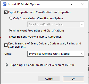

Hi all.
so we've got an AC 25 project with one of the boundary corners set to AC Project Zero & using the Native Survey Point (NSP) to locate said Project Zero / boundary corner to align with a real-world coordinate.
I'd like to export a Revit file but I noticed that there was no option to export from the Native Survey Point.
this becomes an issue because we're also using IFC exports to coordinate with the consultants. in doing so, i'll have an IFC file which will export at the correct location (export from NSP) versus an exported Revit file which will export from Project Origin.
Is there a way for both IFC and Revit file to export from Native Survey Point?

It all sounds very familiar - we used to have a separate export file for real woirld coordinates which thankfully, with NSP, we don't need anymore.
If you were providing a Revit file as a nice gesture then I can understand that you want it to work as you imagined. My follow-up questino would be for your consultant, if they actually work in real world coordinates or if they also work close to project origin.
But as you said yourself, the post is a couple of days old and I just stumbled on it today...and as far as I know there is no option to Save as...Revit and use NSP.
Perhaps if you have a separate export model (like your previous workflow) and save your RVT from there. I know it's a step back but it may work...

Forget the rvt export.
It is useless for Revit users, because it is dummy unusable geometry only.
It takes ages to save a rvt file from Archicad anyway.
I suggest you use IFC 4.0
In the translator turn off survey point, use project origin only.
Revit users should Import (not open) your IFC 4.0 file into a vanilla Revit file. Revit will automatically generate a rvt file. Revit users can then use this rvt file to import as background for coordination.
I know it sounds complicated,  but trust me, atm this is the fastest and best coordination method.
