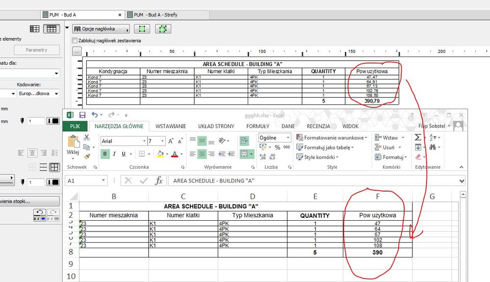

Hi.
Is this a bug or what ?
After "save as" a schedule to Excel ( no matter if .xls or .xlsx) numbers are flattened to integer numbers without anything after the coma.
number 45,23 becomes 45
number 23,78 becomes 23
This happens for every number, area, dimension etc.
Schedule exported to Word (.doc) has all numbers perfectly OK.
I'm working on AC19 with latest update "5005 POL FULL".
Any ideas on "options" for exporting to Excel,
Am I missing a place where can some option be changed on how to export a schedule ?
PS - It's not about formatting cells in Excel, those numbers have their values really changed.
1 REPLY 1
rozky
Yes this is bug. new update 6006 will fix it.
