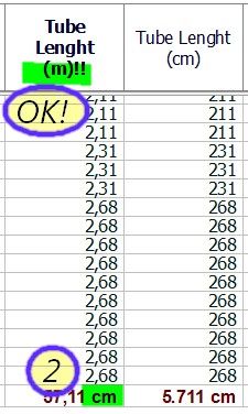

I made a schedule in AC15 for TUBE object elements. There is a problem with units display in the SUME fields. Units are set in "cm" (Working and Calculation). The schedule shows 57,11cm. But I want 57,11m!

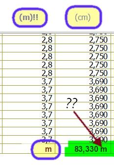

I export the schedule and then import it in AC16 where units are set in "cm" (Working and Calculation). Now both sume fields shows "m"??
Is it possible to change the unit marked with "2" or get rid of it ?.
Any idea?

The same Schedule in AC16:
