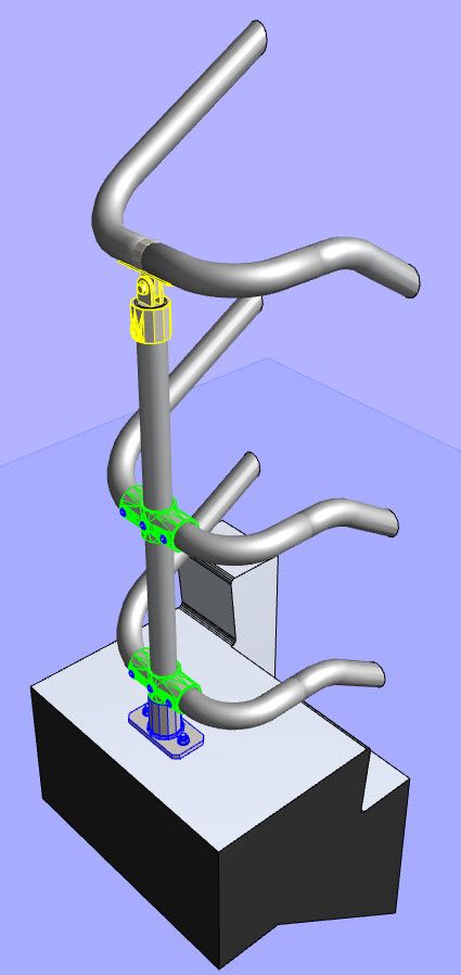

I think I have what you need, now that you don't need it anymore
I have individual .gsm parts for hand railing systems. set screws, fittings, washers, bolts, nuts, anchor bolts, tube...
There is way too much effort involved if you have to model a railing system like this up from scratch. There are about 500 parts in the model shown in this picture. The advantage of having a model like this is that all you need to do is grab a group of parts and drag them over to you new stair or ramp. There is very little adjustment needed to make new railing systems from a model like this.
The Interactive Schedules that go with it are automatically updated of course per your model. I don't have cost data included in the model parts but that would certainly not take much effort.
There are websites with both pipe railing models of many arrangements and also websites with all of the individual parts in SketchUP, .dwg, and other 3d formats which are easily imported into ArchiCAD using the Translator.
Perhaps you can import a stair almost exactly like you need and then just tweak it a little. ?
Since using the Translator tool will automatically generate .gsm parts for you, to make your own schedule would just be a matter of setting it up to include those automatically generated .gsm objects.
It is a little more complicated than that but I hope you get the idea of how it is done.
I am playing around with schedules and I think I will end up having the parts scheduled by layers. This is because I like to have Views of each set of components so I can visually verify the schedules if I need to do that.
The Interactive Schedule is great for this because if the count does not seem right you can select the objects from the schedule and go to a view of them.
It is very helpful in finding any little parts that many have ended up on the wrong layer.

I had to make the parts rather crude to keep the poly count down which is why the parts are not as smooth as they could be.
I tried a few model parts that were very smooth and round but the file size was off the charts.
