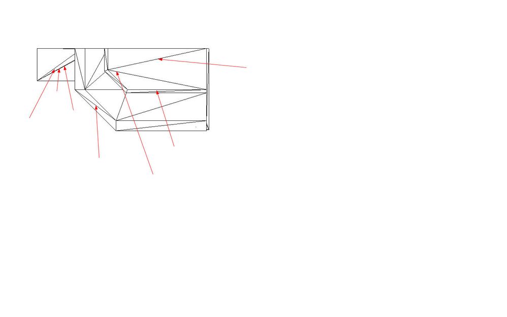

Why is it so much trouble to import a sketchup component in to AC 12 and make a GDL object of it. Can someone please show me the simplest way to do that. I have tried ewerything.It is written on severals web pages that AC and Sketchup has married and shall work well together.!!!!!! A bad marriage i will say.Why cant there be a straightforwade way to do this instead of converting to 3ds and all that way around.

Here are the file in 2D.Look at all the disturbing lines.
These lines will be gone when i render the pickture.
You can change the 2D appearance of your object. Select it, then go to File > Libraries and Objects > Open Object. Open the 2D Symbol and make the desired changes. For more information, please see this thread http://archicad-talk.graphisoft.com/viewtopic.php?p=117845 .
And one more thing. Instead of saving your file in 3ds format, have you tried the SketchUP Import Add-On http://www.graphisoft.com/products/archicad-solutions/su_plugin_download.html ? I must confess that I haven't tried it yet, but maybe it makes a difference.

Editing the 2D symbol in the GDL script is fairly easy. What I dont understand is why the auto settings imports using the roof tool? I would have thought the Mesh tool would be better?
BINGO!
After playing around with the manual import transfer settings i have solved the problem of huge chunks of material hovering above the object.
I don't know the answer to that question. So, it seems that saving to 3ds would be the best choice after all.
