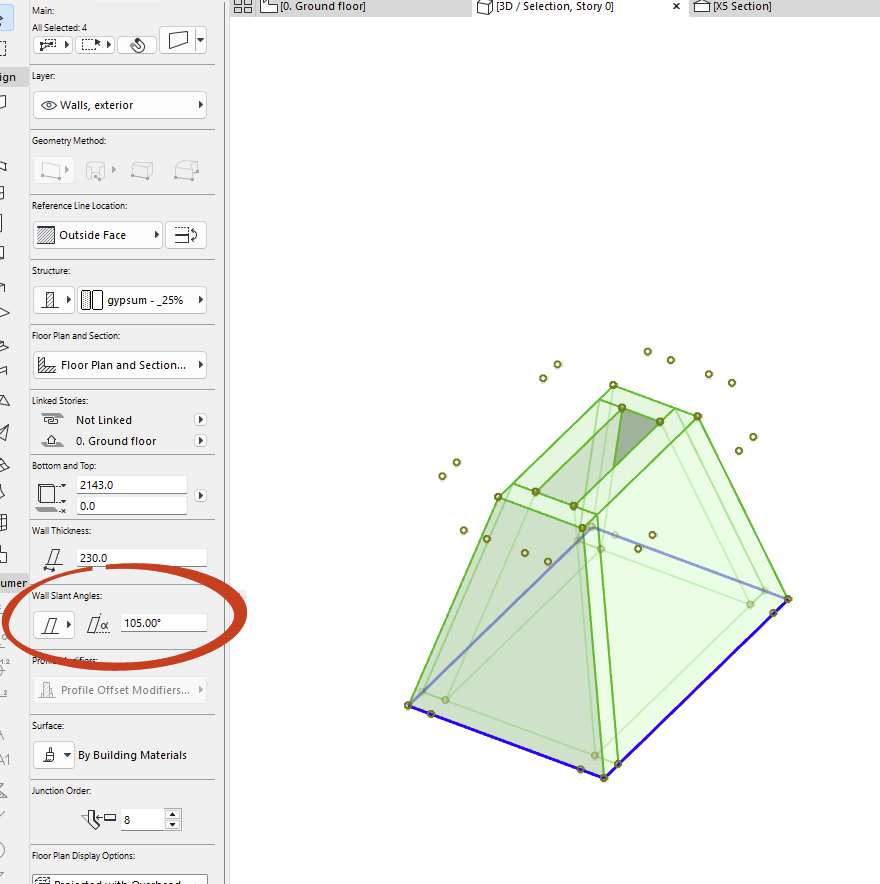

You can incline walls and they will trim with themselves.
Or you could use roofs.

you can also just use a multi-plane roof with an opening in the center
clauds1223
Thanks, how would I add an opening?
Just use the pet palette option to cut a hole.
