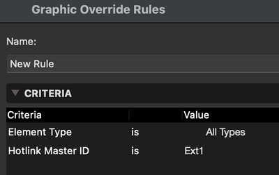

Regarding changing linework, you can filter your Graphic Override by Design Option and/or Hotlink Source.

Claudiu Serban
Interaction old and new: as Ling said, GO. You have each addition on a master layer. Let's say you have 3 additions, you have 3 layers - Modules.Ext1, Modules.Ext2 and Modules.Ext3. When hotlinking them, in the Master layer select the correct Layer and add a master ID so you can easily filter in GO.
Now all elements, besides their own layer, are on this master layer and have this unique property of Master ID.
If you want to do something special with them (make them all red, or change line type or pen), do a GO and filter by these IDs.
Also, if you want to show/hide that entire addition, all you need to do is turn it's hotlink layer on/off.
If you need special modifications in the OG file (some stuff that dissapears when the new extension comes in - some landscaping or pathways or whatever), then you can assign those elements to DO, and turn them on/off in the required views (on in the before, off in the after). This requires more work, but if you want to work non destructively and have all the phases modeled and documented, i don't see a better route (except maybe the old doubling of layers, but thats even more work).
