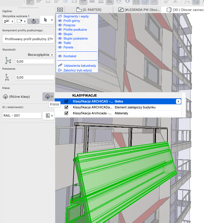

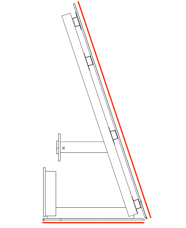

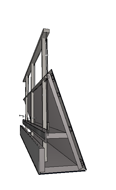

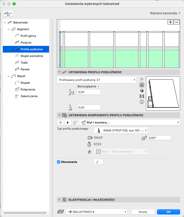

I am trying to extract the exact material surface area (m2) for a specific part of a balcony. I modeled the slanted balcony panels using the Railing Tool, where the panel itself is a Complex Profile acting as a Rail (Profil podłużny).
My main goal is to calculate the square meters of the outer finishing material of these panels for a quantity takeoff.
Here is what I have discovered so far: I noticed that if I go into Edit Mode for the Railing, I can select this specific sub-element (the rail/panel) and assign a unique Classification to it (see attached screenshot). I suspect this might be the key to isolating this specific part from the rest of the Railing in the Interactive Schedule.

Any advice or best practices for scheduling Railing sub-components would be greatly appreciated! I've attached screenshots of my Complex Profile and the Edit Mode interface.
