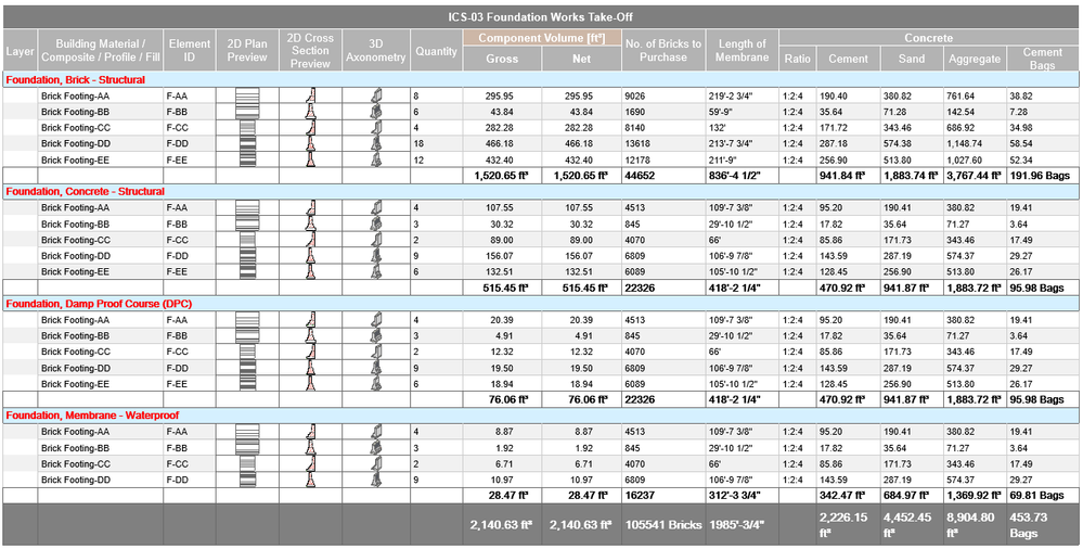

I'm working on a BIM-Screenshot 2026-08-04 114156.pngbased quantity take-off system in Archicad 29 and I've encountered a limitation that I can't seem to solve.
My Workflow
I created a Complex Profile Foundation containing multiple building materials/components:
  • PCC (Concrete)
  • Structural Brickwork
  • Damp Proof Course (DPC)
  • Waterproof Membrane
Using a Component Schedule, I can successfully extract each component separately by using the "Building Material / Composite / Profile / Fill" field. The schedule correctly displays each component with its own Net Component Volume.
For example:
  • Brick - Structural → Net Volume
  • Concrete - Structural → Net Volume
  • DPC → Net Volume
  • Waterproof Membrane → Net Volume
This part works perfectly.
The Problem
I created custom Property Expressions to calculate:
  • Number of Bricks
  • Cement
  • Sand
  • Aggregate
  • Cement Bags
The issue is that Property Expressions only expose the general "Net Volume" (Owner Element Volume) instead of the Component Net Volume.
Because of this:
  • Brick calculations are also applied to PCC, DPC, and Waterproof Membrane.
  • Concrete calculations use the total element volume instead of the current component volume.
  • I cannot calculate materials correctly for each individual component.
Another Limitation
Inside the Property Expression editor:
  • Component Volume is not available under Parameters & Properties.
  • Building Material is also not available, so I cannot write an IF condition such as:
IF Building Material = "Brick - Structural"
to limit the calculation to brick components only.
My Question
Is there any workaround to:
  1. Access Component Net Volume inside a Property Expression?
  2. Detect the current Component Building Material inside an Expression?
  3. Calculate different values (Bricks, Cement, Sand, Aggregate, etc.) for each component within a single Component Schedule?
Or is this simply a limitation of the Archicad Expression Engine?
I'd really appreciate any suggestions, workarounds, GDL tricks, Python API solutions, or BIM workflow recommendations.
