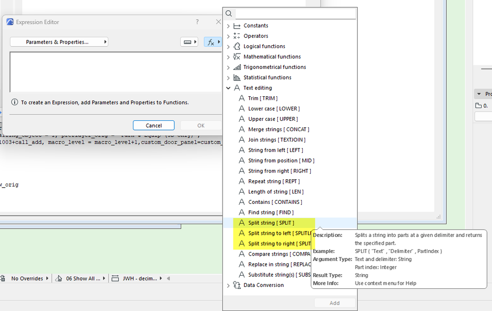

Is it possible to use a SPLIT expression where the delimiter is " ?
We have long product names where the standard format is 'TYPE OF FINISH - MANUFACTURER PRODUCT "COLOUR"' and I'd like to be able to seperate the COLOUR component of the long name.

Masking with a backslash should do the trick:
SPLIT ( <your property>; "\""; 2 )

There are SPLIT functions in the expression editor.
It might be a multi-stage process though.
SPLITRIGHT to get COLOUR" and then SPLITLEFT that result to get just COLOUR.
The only problem then is the functions use the double quote symbol in the command.
I am not sure if you can change that.
So instead of "delimiter" - because """ (triple quotes) would make no sense, you can change it to a single quote 'delimeter' - so you will have '"' in the expression.
Changing to single quotes works in GDL, I can't say I have tried it in the expression editor.
4 hours ago
Barry, thanks for the response. I understand the SPLIT functions in expression editing. My qeustion was more about if it is possible to use the double quote marks as delimiter as we have hundreds of surfaces in this format and would rather not rename all of them through all of our standards.
