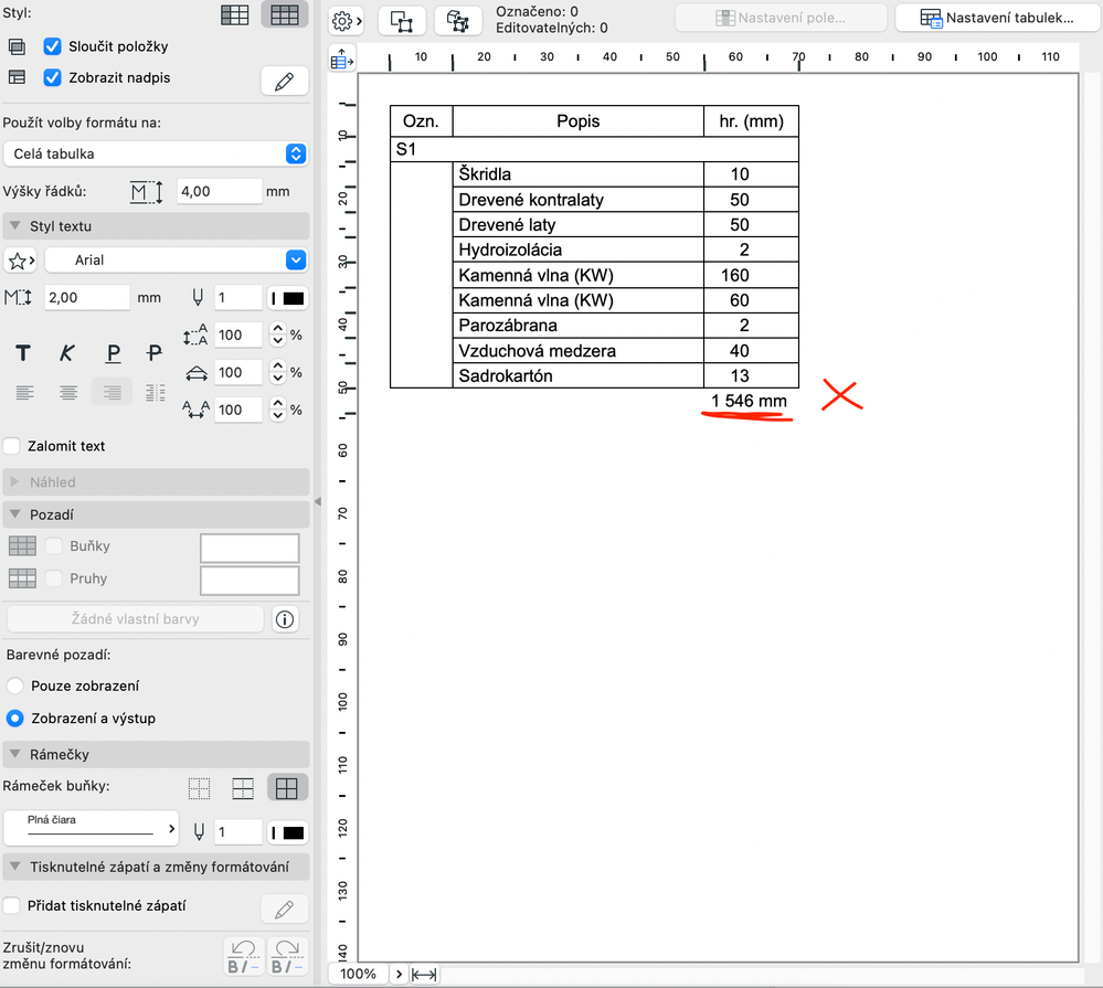

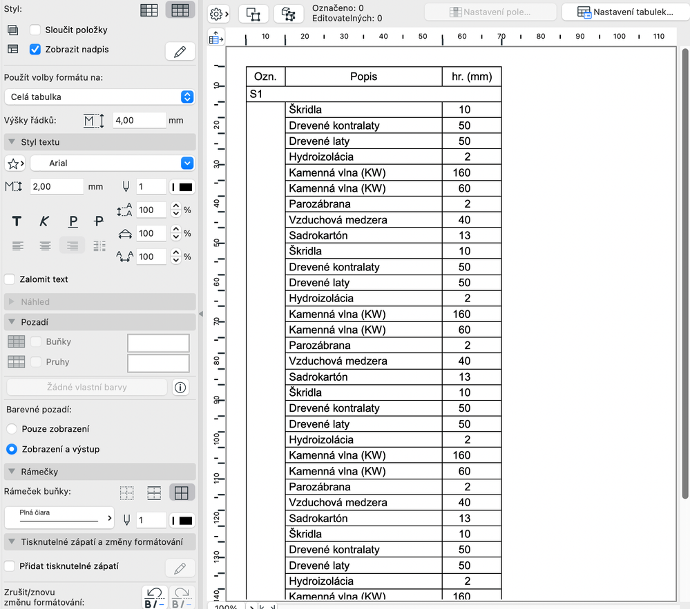

Archicad Interactive Schedule shows a single multi-plane hip roof as four separate elements

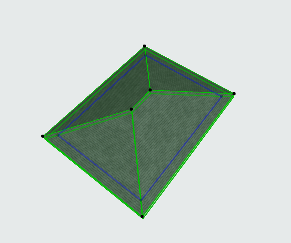

I have a hip roof modeled as a single Multi-plane Roof element in Archicad. However, when I create an Interactive Schedule, Archicad lists the roof as four separate entries, one for each roof plane.
Is there a way to make Archicad treat the entire Multi-plane Roof as one element in the schedule, so that it appears as a single row instead of four separate rows?
I want to create a schedule showing the roof build-up/composition and sum of all widths of the composition.
