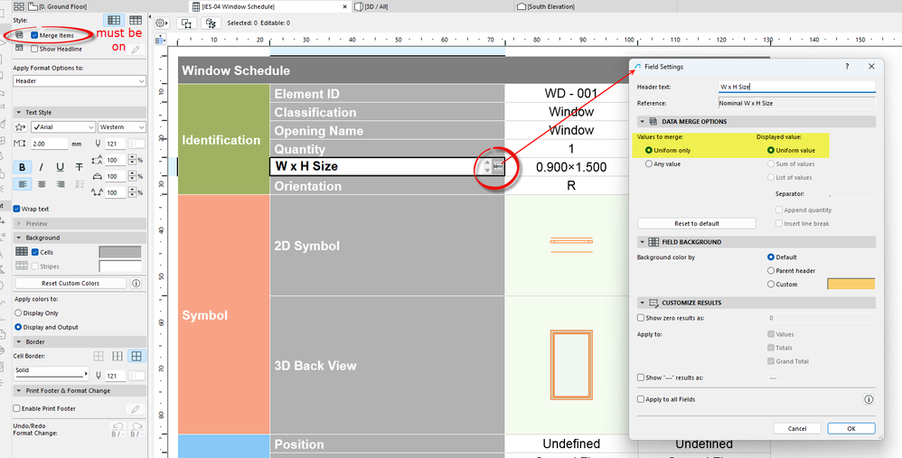

Check the field settings.
For some fields you can choose if you want a unique value or a sum.

Hi Barry,
thanks for the reply. I knew already, but it is not the case for the length and width of the doors. And that parameter that you highlighted is indeed shown correctly, since the numbers are then in plain text transformed through the expression.
