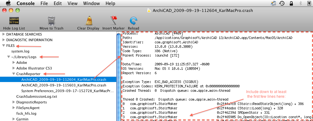

No problems at all here - other than a crash today opening a GDL object (!) related to StairMaker that I sent in.
Did the Apple (or Graphisoft) bug reporter appear after the crash? Do you know how to find crash logs using Console? If you run Console, you'll see something like the attached. Maybe you could copy/paste the part that I show in the red box in the screenshot to see if that helps us. (You can grab the text - don't need to do a screenshot.)

Hi Karl, thanks for your interest.
The Apple and Graphisoft bug reporters both launch after every crash. I have sent the Graphisoft one off and I have posted the Apple one on the Discussions part of the Apple support website under Snow Leopard. The Console report is quoted below, to just beyond the crash as you suggested:
Process: ArchiCAD [592]
Path: /Applications/Graphisoft/ArchiCAD 12/ArchiCAD.app/Contents/MacOS/ArchiCAD
Identifier: com.graphisoft.ArchiCAD
Version: 12.0.0 (12.0.0.2675)
Code Type: X86 (Native)
Parent Process: launchd [88]
Date/Time: 2009-09-19 22:03:55.306 +0100
OS Version: Mac OS X 10.6.1 (10B504)
Report Version: 6
Exception Type: EXC_BAD_ACCESS (SIGBUS)
Exception Codes: KERN_PROTECTION_FAILURE at 0x0000000000000000
Crashed Thread: 0 Dispatch queue: com.apple.main-thread
Thread 0 Crashed: Dispatch queue: com.apple.main-thread
0 ??? 0xa00da610 _XHNDL_trapback_instruction + 0
1 ...ple.ApplicationServices.ATS 0x9471504f HandleOFAScalerMessage + 4615
2 ...ple.ApplicationServices.ATS 0x94713dde SendStrikeMessage + 162
3 ...ple.ApplicationServices.ATS 0x9471d65f _eOFAGetGlyphData + 626
4 ...ple.ApplicationServices.ATS 0x9471cbfc _eGetGlyphAddresses + 2817
5 ...ple.ApplicationServices.ATS 0x9476de08 GetGlyphAddresses + 97
6 com.apple.QD 0x9174aa7b ATSBlitGlyphArray + 371
7 com.apple.QD 0x9174b52c RenderStringOffscreen + 431
8 com.apple.QD 0x91749102 RenderGlyphs + 4862
9 com.apple.QD 0x9174a7a4 StdText + 2587
10 com.apple.QD 0x9174a889 CallText + 59
11 com.apple.QD 0x9174a8e4 DrawChar + 26
12 com.graphisoft.TextEngine 0x03dbefb6 TE::FontFamilyInfo::CalculateSizes(short) + 436
13 com.graphisoft.TextEngine 0x03dabbb8 TE::FontFamilyInfo::GetMaxCharWidth(double) + 58
14 com.graphisoft.ArchiCAD 0x0076203c APIAttribute_Get(APIClient*, API_Attribute*) + 1760
Does this give you any clues as to what is going on? There have been 12 views of my post on Apple Discussions but no replies.
