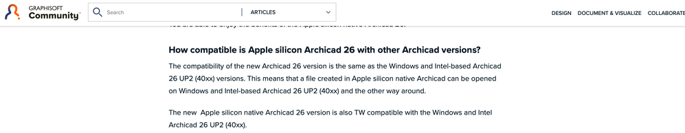

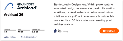

Jono
Is there a current update on this?
The download versions for 26 are:
4024 for Silicon and
3001 intel.
However on intel now my Update lists 4034 as current *note This is a macOS 13 Ventura compatibility update.
we work with a correspondent who has upgraded to silicon we are yet to. the issue is build numbers and Bimcloud teamwork file versions and specifically the file been authored on the later version been accessible to us on intel version.
latest available updatelatest available updateSilicon base numberSilicon base numberIntel base numberIntel base number

Jono
I think I have answered my own question doing some more searching.
see image.
