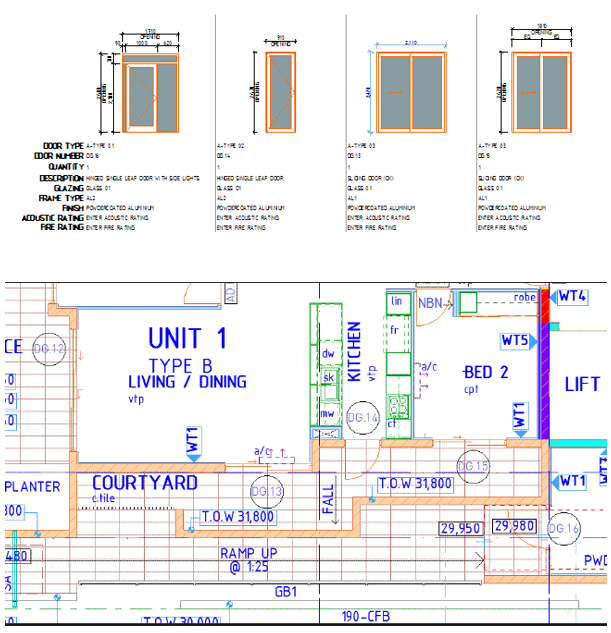

I have a window system that was used in Auto-cad and am having trouble producing a similar system. Archicad calls up all the different door TYPES. The doors are then all tagged ie. DG01-DG15 (door ground 1-15). The problem I have is once the door is tagged Archicad reads it as a different door.
Is there anyway to have a different Door tag number and keeping the door type is the schedule.
The attached will hopefully assist with understanding my request.

Unfortunately not. You could group the same doors under same column if you go to "Document"- "Schedules and Lists" - "Schedules" - "Scheme Settings" - "Door Schedule" and remove the "Compact element ID" field.
Add a "Custom text" field where you'll have to add all the door tags (DG01...) manually later.
I looked at the image, but I don't think I understand what you are trying to achieve. If this issue is still current, would you care to elaborate?
