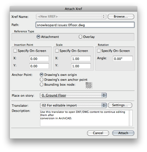

You can attach the DWG file as Xref with File/External Content/Attach Xref... command or with selecting Attach in Xref Manager dialog. In the appearing dialog browse for the DWG file and set its options.
Xref Name: Specify the name of the DWG file to be attached with browsing for the file or if it is alreday attached, with selecting the file from the pop-up list.
Path: Shows the exact path to the selected file.
Reference Type:
Attachment: All levels of nesting can be displayed in the Project file.
Overlay: Nested XREFs from the referenced file will not be visible in the Project.
Placement Parameters:
Insertion point: In the X and Y field, you can enter the exact coordinates of the location of the lower left corner of the enclosing rectangle or of the Drawing origin. Alternatively, you can check the Specify On-Screen box to enter these coordinates by clicking on the Floor Plan.
Scale: Either specify a scale factor in both X and Y directions, or check the Specify On-Screen box to define scale on the screen.
Rotation: You can define an angle by which the whole placed XREF will be rotated around its insertion point, or check the Specify On-Screen box to define rotation manually, on the screen.
Anchor Point: Use these controls to define by which point of the XREF to place the drawing.
Place on Story: Use this drop-down list to choose the story onto which to place the XREF.
Translator: This field displays the currently selected DXF/DWG Translator to be used during the conversion of the attached AutoCAD drawing.
