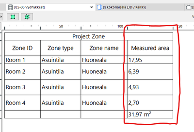

Is it possible export zone area values to ifc-model, especially combined value?.

You mean the Total value displayed in your screenshot?
I do not think it is possible because it is calculated when the Schedule is generated, it is not available as a value in any of the Zones when you are exporting an IFC file.
