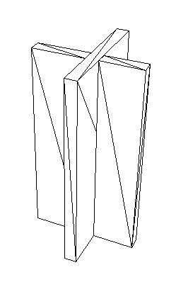

When I send my volumes from Archicad to cinema, everything is ok. When I come back to Archicad I see in my volume all the triangulate sides like in the picture. It is the same in cinema 10 and 11. It didn't happen in archicad 11 and old add on.
Everything in cinema is set correctly (smooth etc.). I repeat: the same operation works properly in archicad 11 and old addon hidding the sides properly.

I have the same problem and they told me they were going to fix this problem.
The other problem I have is that I can not change the materials of the seperate components of the object when sent back to Archicad.
Also the objects arrive on the wrong floorlevel when sent back.
