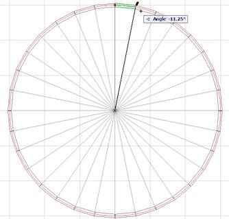

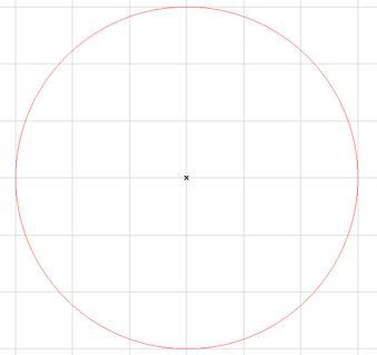

1. Draw the circle or arc of the Spiral.

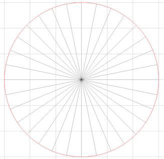

2. Decide on the resolution of the arc of the Spiral. Consider the size and full length of the arc. In our case let us create a full circle out of 32 segments. Let us draw the segments for the arc/circle.
3. Draw an inclined Beam segment along the circumference of the arc/circle between two division points.
4.Go to the 3D Window and increase the inclination of the Beam so it is the desired value. For example, if the total inclination of the Spiral is 4800 millimeters, then one segment will incline 150 millimeters.
Hint: You might want to set your Working Unit to the highest possible value for best accuracy during input.
5. Go back to the Floor Plan, select the Beam segment and use the Multiply command with the Rotate option. The vertical displacement should be the inclination of one segment since we want the segments to join properly in the Z direction.

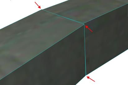

7. Notice one thing however: if you zoom in very close to a point where to Beam segments join you will see that the join is not perfect. For them to be perfect the Beam would have to have the ability to have a distorted section, which it does not.
So this is a limitation therefore you should set the resolution to a large enough value so these errors are within tolerance.

6. Click OK to accept these changes, then click the center of the circle to place the Ramp. Then delete the circle as it is not needed anymore.
