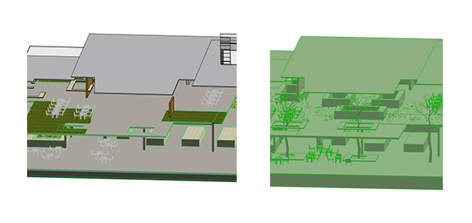

Hi guys,
A building model that I'm working on, usually normal in colour has started appearing as a green form. It stays this way when saved and opened in 3D max, but appears as completely blank when saved and opened in sketchup, where as before it would open in sketchup with all of it's material finishes and colours.
Any help with knowing how to turn it back to it's original finishes / colours would be appreciated!
Thanks!
2 Replies 2
Check your renovation filter in 3D window. It may be overriding finishes (surfaces).
Hi Stuart,
I just reset the renovation status and now it works perfectly. Thanks so much!!
