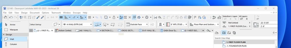

ArchiCAD statusbar top right is hidden when the window is maximized.
Gisele
I have two monitors. When I maximize ArchiCAD's window, I cannot see the top right corner of the statusbar.
Attached are two screenshots showing a maximized and a minimizes ArchiCAD's window. It could be a resolution issue, but I don't know how to address it.

Well, it's not the statusbar, which is at the bottom of your screen (if activated), but the Info Box, which contents change depending on the selected tool.
The Info Box contains different settings, which take up some screen space. If this space gets smaller, they don't fit into any more, but extend beyond the border - the Info Box does not resize with the window width.

Also, the Info Box is scrollable, but many mice do not have an easy horizontal scroll function.  It's just one more reason not to use a horizontal Info Box.  Instead, drag the Info Box to the side of the screen (left is a common location) where it is both more visible/useful... and can be scrolled with the vertical mouse wheel or touch function.

Thank you, Karl!
I did not know that I could scroll the info bar.
