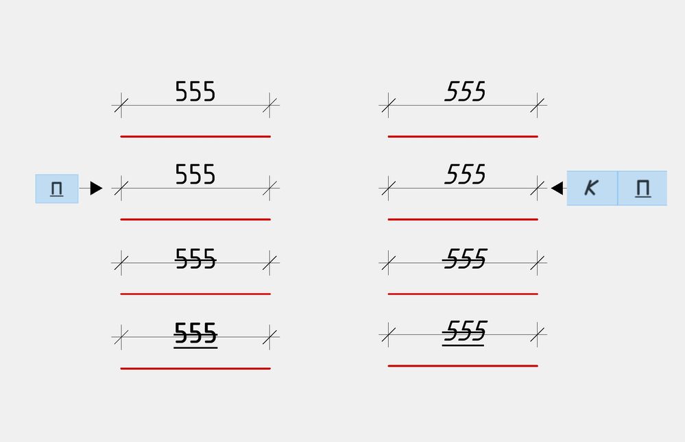

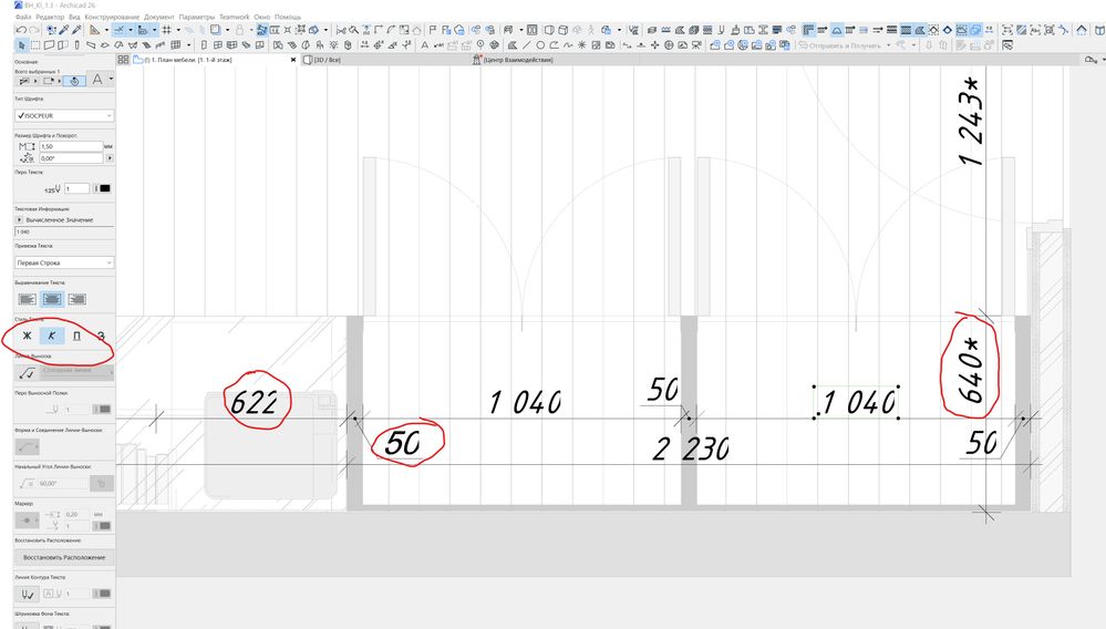

Another problem with the graphics in version 26. (Dimensions)
Inclined (italic) numbers in the dimensions, are cut. The font is cropped horizontally, there is no problem in the vertical dimensions.
There are also problems with other font display modes on sizes.
- no underscore
- size displacement if it is crossed out

I ran into the same problem, and temporary solution is to make the line spacing = 75%
But the problem is that the line spacing is not available for some elements (for example, Axes)
Another solution was to use the old text engine. I found it here in the comments.
https://community.Graphisoft.com/t5/Document-Visualize-forum/Fonts-displaying-incorrectly-after-movi...
