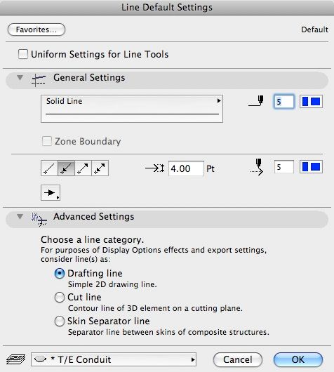

I've never been able to get the arrowheads on lines to plot very well, they have always plotted out very faint grey, even when I plot to black and white. It does not matter how heavy the line weight is, what color, or what size the arrowhead is, it always plots a faint grey. Everything else prints perfectly but the arrowheads.
What am I missing here? It is probably some silly preference or something I just cannot find.....

So, the arrowheads. I am plotting to an HP1055CM DesignJet plotter, with the ArchiCad drivers/plotmaker, it you can call it that anymore, with the publisher. My plot settings are Black and White, NOT Hairline, connected through TCP/IP ethernet.
On screen display is fine, my view options are true weight. Export or publish to PDF looks perfect at 1200 dpi, also publish to any other format. It is only when plotting. My line weight for the lines is .57 all the way up to 2.5, it doesn't matter the line thickness/arrowhead size, it will still plot faint grey even though the line will plot nice and dark, crisp heavy black.
I just can't imagine why arrowheads would plot with any different properties than the lines they are associated with. My line default settings are set to Drafting line, simple 2D drawing line. Everything plots exactly perfect except for arrowheads. It seems as if the arrowheads are being treated as a 50% fill or something.

One thing that you haven't mentioned, is whether you are printing from a layout, or directly from the plan. If from a layout, there will be a pen set that needs to be adjusted to be correct.
Also, even if your plotter is set to print in B&W, ArchiCAD needs to be set to print in B&W also. If you are printing greyscale, then the pen sets in layout become more critical.
The other thing that strikes me is that your lineweights seem like they would be very "blobby." You might try a thinner lineweight for the arrow.

Thanks Richard, I print from layouts, I haven't thought about the pens for the layouts, I assumed that since "plotmaker" is now a part of ArchiCad that the model pens would be the same pens for the layouts.
I think you are on the right track, I'll look into it now. The pen I posted was a heavy line, I usually use something much thinner for arrows.
